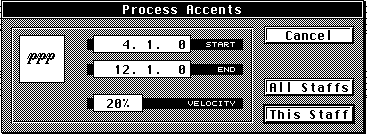

Tip: Cubase Score has a function obtained by double clicking a dynamics symbol, that allows you to alter the midi data within a range. First, however, go through the entire arrangement making all notes maximum velocity. You can do this very quickly by using 'Select All' from the Arrange window, then using the 'Transpose/Velocity' selection on the Functions Menu. Set it to 127 then click 'Do'.
[Image]Now you can 'double-click' your dynamic markings and alter the midi data. Cubase has two types, Process Crescendo (double-click a Crescendo marking), and Process Accents (they don't mean accents, that's a mistake, they mean Dynamics - anyway, double- click a dynamics marking). The recommended amounts are set up by default and they're about right. By doing this you will be getting a general feel for if your dynamics are close to what you want, and you will be fairly sure that the players will get that pretty much the same. They will be a bit better as they also are blessed with ears.

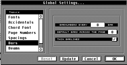

[Image]First, the best looking and efficient 'Page Mode' setting is shown here, the 'real book' setting makes the clef appear only on the first line of the page, and the 'thin bar lines' setting really helps to make the notes stand out more. Well that's the only time I've put in opinion. I use a laser printer, maybe on other types of printer things may look different.
Masterscores, with all parts appearing, can easily be sorted out by using the auto layout function. Setting the number of bars per line in the 'Global Settings' first, to a high-ish number like 8 will save space wherever possible.
