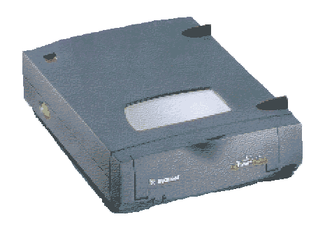

[Image]The SyQuest EZFlyer 230 is in shape, size and looks, very like the Iomega Zip, but a little sturdier in construction. It even uses the 'Mac' type DB-25 pin SCSI, in and out, connectors like the Zip. Apart from the colour, it differs from the Zip by having a power button on it's side and a flip down, dust-proof, door covering the cartridge slot. My final mention of the Zip [we are not comparing the two drives, they are technically very different] is to say that it was lucky I had one or we wouldn't have been able to plug the EZFlyer [let's just call it the "Flyer" from here on] into my system.
The Flyer is an atractive looking blob to add to your desk and as with all SyQuest devices it is well constructed. I was pleased to see the dodgy cartridge release lever from the EZ135 had been replaced with an eject button. The PSU is external and unlike the early EZ135s it is small and has plenty of cable. Setting the SCSI ID is done by holding down the power switch while pressing the eject button. I watched Domhnall get a little confused at first, but on second attempt he got it right. You can check the ID by button pressing too.
