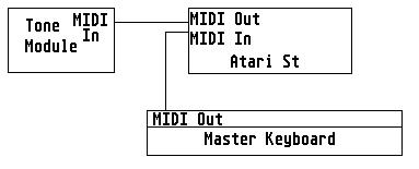

You've now got your Tone module and MIDI controller or GM Keyboard, and you just know you will have to set them up with your Atari - heavens, I hope it's easy. Well lucky old us, it couldn't be simpler. All you need are 2 MIDI cables. Ensure you buy MIDI cables not 5 pin DIN cables as the later can cause problems.
If you have a GM Keyboard skip this paragraph and jump to the
next one, otherwise here we go - You connect the MIDI Out on the Atari
to the MIDI In on you Module, then you connect the MIDI In on the
Atari to the MIDI Out on your MIDI controller which is most probably
going to be a keyboard. You are now ready to Rock and
Roll - Nearly . You can now jump ahead to choosing a sequencer.
Hello again GM Keyboard owner, hope you didn't find that too
much of a jump - You connect the MIDI Out on the Atari with the MIDI
in on your keyboard, then connect the MIDI In on your Atari with the
MIDI Out on your Keyboard. You too, are ready to Rock
and Roll - apart from your software.
