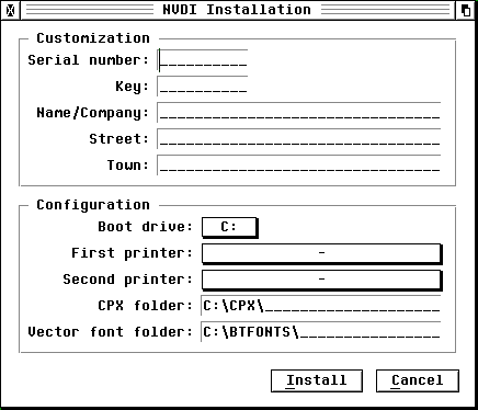

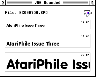

NVDI 4 arrives in typical System Solutions style. Two 3.5 inch DD disks with a 32 page manual in an A5 plastic wallet. The first thing that strikes you about the package is the manual, "Atari ST/TT/Falcon 030/Mac", it proudly boasts. Mac? A clue perhaps to which area of computing NVDI 4 now covers. A Mac running MagicMac (required if you want to use NVDI 4 on a Mac) is already many times faster then a Falcon running MagiC 4, even if that Falcon's been fitted with the latest accelerator card. Surely NVDI 4 isn't going to make the Mac appear that much faster, and you're right it isn't. Making an Atari look faster by speeding up its screen display is no longer NVDI's main function. That function still exists, and is still performed with expert skill and reliability, however its font scaling or SpeedoGDOS functions now surpass its previously primary job of acceleration. This is the main reason for including Mac as a choice when it comes to system requirements. It allows the Mac under MagicMac to access Speedo's font scaler thus making MagicMac even more Atari compatible.

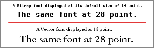

I'm not a Mac user and this isn't a Mac mag so lets get back to the Atari. NVDI in this country has always had a GDOS replacement built in. This, as I've already said, has developed into a full blown SpeedoGDOS replacement which has really come of age in version 4. It supports Speedo and TrueType vector fonts as well as the older bitmap fonts familiar to those of you who've had dealings with GDOS 1.1. The difference between vector and bitmap fonts is well known but for new comers to this area here's a very quick run down.

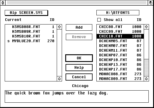

To activate a font it had to
be copied to the font folder called BTFONTS. To stop a font from installing you
copied the font to a folder called HIDE inside the BTFONTS directory. Not a difficult
operation I agree but some of the font file names can be pretty cryptic, so you
often had problems identifying the fonts you wished to install or hide. This
problem has been addressed with the inclusion of Fontname. A utility designed to
ease the font installation process. Fontname can also be used to view fonts and
print them.

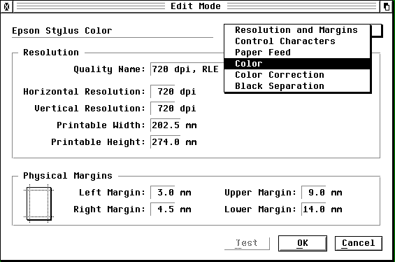

Printers are obviously a vital part of all modern computer systems and it's great having vector fonts on screen but little point if you can't print out your latest best seller. NVDI 4 caters for all major printers, but for those of you who wish to fine tune it's performance for your particular printer the program Makeprn is supplied. Within this utility every aspect of your printers operation can be adjusted, including colour.
