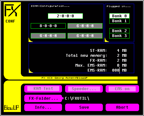

This dialog is used to set up the FX card Simm banks. As
you can see the banks are numbered 0 - 3. Banks 0 and 1
are on the card, banks 2 and 3 will be available after
fitting a future expansion card to the FX. It is hoped
that this will allow Falcon users to access more than the
current memory limit of 14Mb RAM. One of the great things
about the card is in its ability to be updated via soft-
ware. The main chip on the board can be reprogrammed. All
BlowUp have to do is send you a floppy containing the new
code. After running software on the disk the FX's main
chip will have been updated. With this approach Blow Up
will also be able to refine the accelerator code. An easy
and cheap method of keeping the FX card up to date.

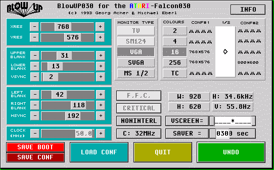

Once I'd discovered what was causing the incompatibility problems and had set the program flags to suit I had no more problems. Not one piece of software has taken a dislike to the speed increase. My initial fears of the FX causing my Falcon to become unreliable have proved to be false. I've been using it now for some weeks with no lose of data and no crashes which can be attributed directly to the FX. In fact the Falcon Xtender has delivered exactly what I hoped it would, sixteen colour speed in a 256 colour resolution. I've even had my monitor displaying a resolution of 800 x 600. This I've reduced slightly as my monitor tended to flicker too much for comfort. This is nothing to do with the FX I just need a higher quality monitor (Donations gratefully received).
Using this program you can set up your resolution. Always
take care when using this type of software. It is remark-
ably easy to use and very compatible. I haven't found one
piece of software that clashes with it.
